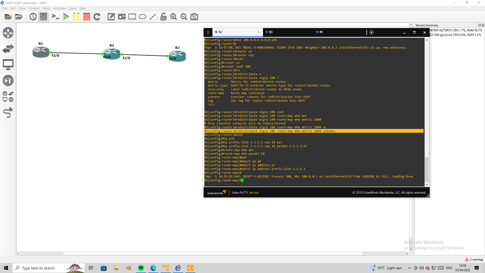

using redistrubte with route-map (this will filter the prefix) and then add metric
check above lab
Am I in same way or in different way'
