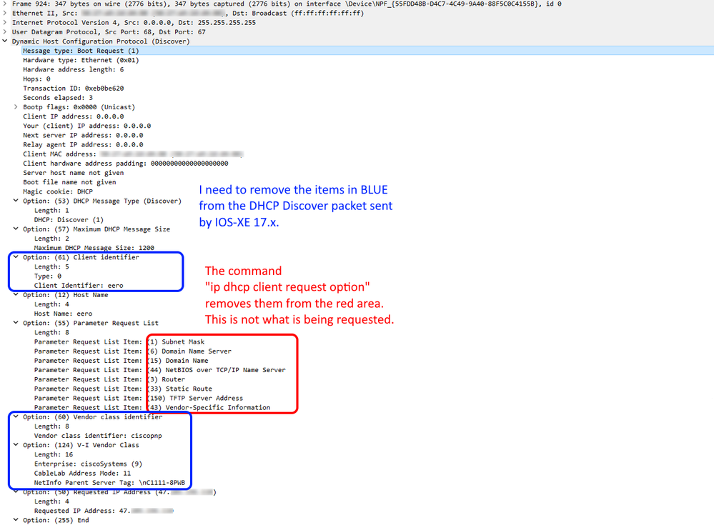

A command like "ip dhcp client request option 4 5 7 8 9 10 11 17 18 40 41 42 66 68 69 70 71 72 73 74 75 76 124 138 141 142 160" is sending a request via option 55 to request more information be sent back FROM the DHCP Server, I am looking to configure the IOS-XE DHCP Client to send less information TO the DHCP Server.
That being said, I did enter the following DHCP commands to the configuration (they make no visible change to the interface config). You will see that the Cisco IOS-XE 17.9.4a DHCP Client is STILL sending option 60.61, and 124.
C1111-8PWB#conf t
Enter configuration commands, one per line.  End with CNTL/Z.
C1111-8PWB(config)#interface GigabitEthernet0/0/0
C1111-8PWB(config-if)#no ip dhcp client option 60
C1111-8PWB(config-if)#no ip dhcp client option 61
C1111-8PWB(config-if)#no ip dhcp client option 124
% Try using 'ip dhcp client request option' command
C1111-8PWB(config-if)#no ip dhcp client request option 124
No.     Time               Source                Destination           Protocol Length Info
    924 12:53:47.796709    0.0.0.0               255.255.255.255       DHCP     347    DHCP Discover - Transaction ID 0xeb0be620
Frame 924: 347 bytes on wire (2776 bits), 347 bytes captured (2776 bits) on interface \Device\NPF_{55FDD48B-D4C7-4C49-9A40-88F5C0C4155B}, id 0
Ethernet II, Src: 50:27:a9:2d:ff:ff (50:27:a9:2d:ff:ff), Dst: Broadcast (ff:ff:ff:ff:ff:ff)
Internet Protocol Version 4, Src: 0.0.0.0, Dst: 255.255.255.255
User Datagram Protocol, Src Port: 68, Dst Port: 67
Dynamic Host Configuration Protocol (Discover)
    Message type: Boot Request (1)
    Hardware type: Ethernet (0x01)
    Hardware address length: 6
    Hops: 0
    Transaction ID: 0xeb0be620
    Seconds elapsed: 3
    Bootp flags: 0x0000 (Unicast)
    Client IP address: 0.0.0.0
    Your (client) IP address: 0.0.0.0
    Next server IP address: 0.0.0.0
    Relay agent IP address: 0.0.0.0
    Client MAC address: 50:27:a9:2d:ff:ff (50:27:a9:2d:ff:ff)
    Client hardware address padding: 00000000000000000000
    Server host name not given
    Boot file name not given
    Magic cookie: DHCP
    Option: (53) DHCP Message Type (Discover)
        Length: 1
        DHCP: Discover (1)
    Option: (57) Maximum DHCP Message Size
        Length: 2
        Maximum DHCP Message Size: 1200
    Option: (61) Client identifier
        Length: 5
        Type: 0
        Client Identifier: eero
    Option: (12) Host Name
        Length: 4
        Host Name: eero
    Option: (55) Parameter Request List
        Length: 8
        Parameter Request List Item: (1) Subnet Mask
        Parameter Request List Item: (6) Domain Name Server
        Parameter Request List Item: (15) Domain Name
        Parameter Request List Item: (44) NetBIOS over TCP/IP Name Server
        Parameter Request List Item: (3) Router
        Parameter Request List Item: (33) Static Route
        Parameter Request List Item: (150) TFTP Server Address
        Parameter Request List Item: (43) Vendor-Specific Information
    Option: (60) Vendor class identifier
        Length: 8
        Vendor class identifier: ciscopnp
    Option: (124) V-I Vendor Class
        Length: 16
        Enterprise: ciscoSystems (9)
        CableLab Address Mode: 11
        NetInfo Parent Server Tag: \nC1111-8PWB
    Option: (50) Requested IP Address (47.xxx.xxx.xxx)
        Length: 4
        Requested IP Address: 47.xxx.xxx.xxx
    Option: (255) End
        Option End: 255
Additionally, you link the 16.10.x Cisco page for IOS-XE DHCP Client when I linked the similarly, but more appropriate 17.x page for the same thing in the opening post. There are several changes introduced in Cisco IOS XE Amsterdam Release 17.2.

PLEASE actually read the contents of my replies. I literally posted the output of the router  not recognizing the command, and what the IOS says are valid options for the command. Here it is again, and yes, the result is the same with 61 and 124:
C1111#conf t
C1111(config)#int gi0/0/0
C1111(config-if)#no ip dhcp client request 60
% Invalid input detected at '^' marker.
C1111(config-if)#no ip dhcp client request ?
  classless-static-route       Classless static route (121)
  dns-nameserver               DNS nameserver (6)
  domain-name                  Domain name (15)
  netbios-nameserver           NETBIOS nameserver (44)
  option                       DHCP options
  router                       Default router option (3)
  sip-server-address           SIP server address (120)
  static-route                 Static route option (33)
  tftp-server-address          TFTP server address (150)
  vendor-identifying-specific  Vendor identifying specific info (125)
  vendor-specific              Vendor specific option (43)
  <cr>                         <cr>
C1111(config-if)#

mcotherman
I have added a screen capture and marked it up for clarity of what I am asking for.

@mcotherman wrote:
My goal is to have the enterprise grade Cisco IOS-XR mimic the eero in what is commonly referred to as mac-cloning, but the ISP seems to be extra finicky.
Packet capture of the latest iteration of the IOS-XE  DHCP Client configuration (no response from ISP's DHCP server)
So to confirm ,your client is and IOS-XE and the dhcp server is IOS-XR.
TBH - mac cloning shouldn't be that hard to accomplish unless spoofing is being negated by the dhcp server?
Secure ARP
In standalone DHCP sessions, the DHCP server adds an ARP entry when it assigns an IP address to a client. However, in IP subscriber sessions, DHCP server does not add an ARP entry. Although ARP establishes correspondences between network addresses, an untrusted device can spoof IP an address not assigned to it posing a security threat for IP subscriber sessions. You can enable the secure ARP feature and allow DHCP to add an ARP cache entry when DHCP assigns an IP address to a client. Secure ARP is disabled by default.
Anyhow looking at your post, could you try (no other options):
shut
mac-address 5027.a92d.ffff
ip dhcp client client-id GigabitEthernet0/0/0
ip address dhcp
no shut
