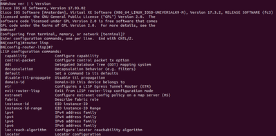

2 different devices, csr with 17.3 version which accepts
router lisp
commands and
c8000v 17.9.4
version which is not taking
router lisp
commnd

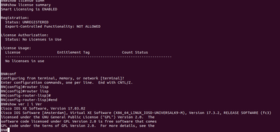

Hi Marco,
The below is screen shot of the cisco
csr iosxe 17.3
which is able to run the command without licence.
whereas
iosxe 17.9
is not accepting the command:
