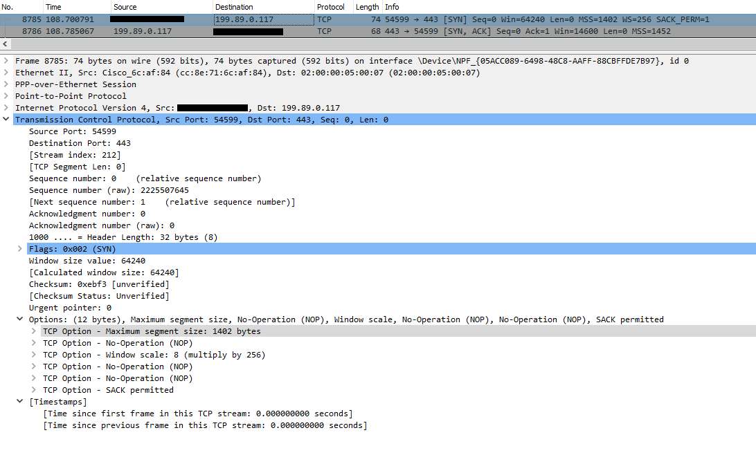

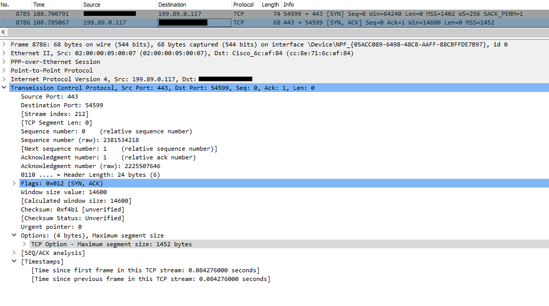

So far it's just this one website that I've found.  I have tested on multiple PC's, mostly windows 10, and also on a Windows 7 VM.  Most windows 10 machines are on 2004/2009 update.  I'm 99% sure it's not a PC issue.  I did a port mirror on the uplink WAN port, and also a port mirror on the LAN side where a pc connected and found:
1. PC sends SYN up to website
2. Website responds with SYN/ACK
3.  Firewall WAN port receives the SYN/ACK
4. Lan port never forwards back down the SYN/ACK to the client

I took wireshark captures on both WAN and LAN ports with inline 3rd party switch with port mirroring. See attached.  SYN from client to server work, server responds with SYN/ACK, RV340 never forwards it back down to client.
