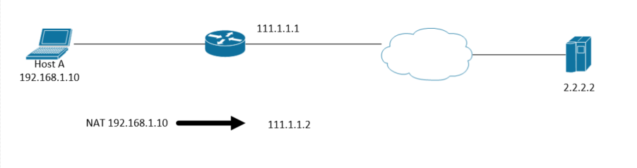

Configure NAT with specific destination IP address
ratha chum
with diagram:
I want Host A NAT to IP 111.1.1.2 when host A access to 2.2.2.2 and don't need NAT when Host A access to other IP.
NOTE: on router doesn't have other NAT rule.
try the below configuration:
interface GigabitEthernet0/0
description Uplink to ISP
ip address 111.1.1.1 255.255.255.0
ip nat outside
interface GigabitEthernet0/1
description LAN Interface
ip address 192.168.1.1 255.255.255.0
ip nat inside
ip nat inside source static 192.168.1.10 111.1.1.2 route-map HOST_NAT
ip route 0.0.0.0 0.0.0.0 111.1.1.254
route-map HOST_NAT permit 10
match ip address 101
access-list 101 permit ip host 192.168.1.10 host 2.2.2.2

Hello
The nat statement @Georg Pauwen has provided shuld accomodate your request -  However you say
@ratha chum wrote:
with diagram:
Can you confirm  192.168.1.0/24 subnet is then reachable externally, if this is the case then this specific internal host will also be.
Kind Regards
