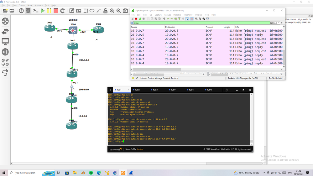

Ip nat inside destination <<- this command I think what you need

Sure draw your topology here and I will share lab how to config İp nat inside destination.
Here is the lab I have built to test this:
