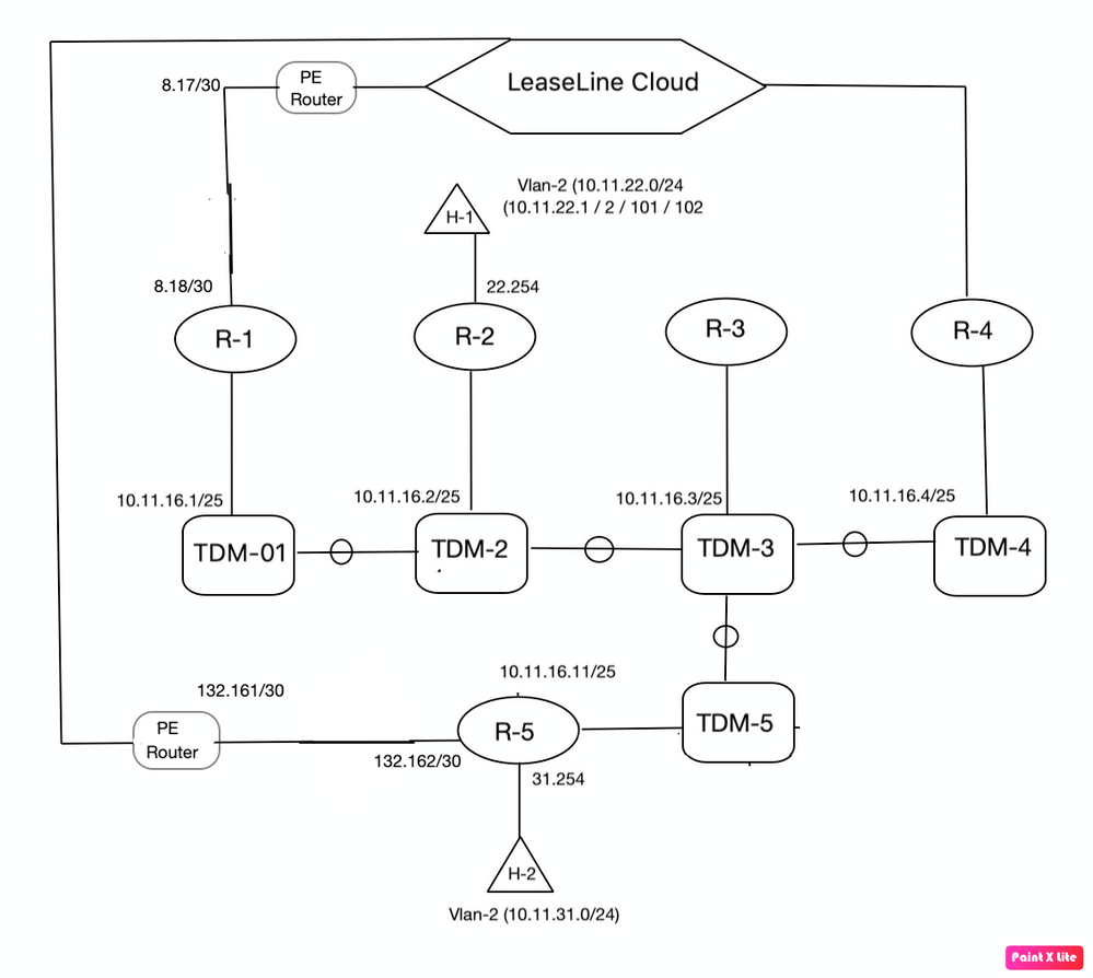

We have 5 nos of location which are directly connected through TDM Fiber optics networks, additionally we have lease line to provide backup path in case of Fiber cut in between any of these 5 locations.
We used EGRP as IGP Routing protocol on TDM links connected to our cisco router, we have published all our local routes over EIGRP routing protocol. Our lease line provider is using EBGP routing protocol for backup connectivity and same has been redistributed into EIGRP. Please refer our network topology in the attachment.
Recently we have seen that when our R-2 TDM connectivity towards R-3 has lost and restored back our data source from H-2 host at R5 to destination H-1 host at R2 stop working, after few troubleshooting we came to know that R-5 is learning H-2 host subnet as external (AD-170) and R2 is learning H-2 router as internal (AD-15) routes. Please refer below output from R-1 & R2.

When our communication was lost, we have used tracert from H-2 (R-5) host to H-1 (R-2) host and observe below hops on continuously cycle due to which TTL expires comes.
(Trace route output)
10.11.31.252. -- (R-5 Local Vlan-2 Interface ip)
10.67.132.161 -- (R-5 LL Provider Edge router Ip)
116.50.125.198 -- (LL provider cloud network)
10.67.8.17 -- (Local R-1 LL Provider Edge router Ip)
10.67.8.18 -- (Local R-1 LL Client Edge router Ip)
10.11.16.11 -- (R-5 TDM Fiber network interface IP)
10.67.132.161 -- (Local R-5 LL Provider Edge router Ip)
As this was happened in production network so to make this up we have used below static route on R-2 for single local host (10.11.22.1) afterward communication established. Please check below routes and show ip route output on R-5 after putting these below routes on R-2.
R2(Config)#ip route 10.11.22.1 255.255.255.255 Vlan2 (This is local subnet for R-2 even though we have tried this and communication was established.)

The route you have installed was a /25. I am guessing based on what I see that the BGP routes might be /24's. Admin distance decides which route is installed when the length of the routes is the same. You could have a /25 route installed for both 10.11.22.0/25 and 10.11.22.128/25 as well as a route for 10.11.22.0/24. The /24 route would never get used because the /25 is a longer match.
On R2 we have Vlan-x with interface ip 10.11.22.100/24 and under EIGRP we have advertise 10.0.0.0 network. We haven't use /25 route anywhere on R-2, however on R5 10.11.22.0/25 route being learned as external routes? is it because of LL provider used /25 mask for 10.11.22.0? and due to which /25 route being preferred over /24 route?
if this is true then how we are going to check what mask is being used and propagated by LL ISP? any debug command?

The mask in the network statement is used to identify interfaces. Only interfaces, and nothing more. The route that will be advertised is based on the netmask assigned to the interface. If you had two /25 interfaces that are part of the same /24 at a site and wanted to advertise a /24 to the rest of the network (which would make sense), you would have to do that with a summary. It is a common misconception that you have to put in a "network" statement to make an interior gateway protocol aka IGP (RIP, EIGRP OSPF) pass a route, but that is not the case. The network statement for IGP's is only to select interfaces. That isn't true with an exterior gateway protocol aka EGP like BGP.
Thanks Elliot for your explanation.
As mentioned above we dont have interface with /25 mask, we only have single Vlan interface with /24 mask however ip route shows 10.11.22.0/25 as external route advertised by bgp. Does this mean ISP advertising this route with /25 mask?
R5 have working EIGRP neighbourship with R2 and R2 has propagated 10.11.22.0 network to R5, in this case R5 should show 10.11.22.0/24 as internal route however R5 is showing 10.11.22.0/25 external route in the routing table? any suggestion to resolve this issue?

If you could check traceroute output it shows that packet targeting 10.11.22.0 network from R5 is getting loop between R5 & R1. When we used ip route on R1 & R5 it show below route in its routing table.
R-5#sh ip route
B 10.11.22.0/25 [20/0] via 10.67.132.161, 20:12:39
D 10.11.22.0/24 [15/25628160] via 10.11.16.2, 17:03:56, FastEthernet0/0
B 10.11.22.128/25 [20/0] via 10.67.132.161, 20:12:40
R-1#sh ip route
D EX 10.11.22.0/25 [170/284160] via 10.11.16.11, 12:53:40, FastEthernet0/0
[170/284160] via 10.11.16.10, 12:53:40, FastEthernet0/0
D 10.11.22.0/24 [90/25628160] via 10.11.16.2, 17:27:15, FastEthernet0/0
D EX 10.11.22.128/25
[170/284160] via 10.11.16.11, 12:53:41, FastEthernet0/0
[170/284160] via 10.11.16.10, 12:53:41, FastEthernet0/0
Please suggest.
