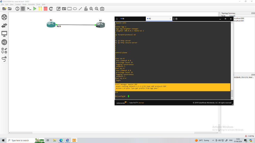

I run EEM for add prefix via BGP and action is show specific message
in your case use same except replace the show message with the send to syslog
MHM
Thanks for output shared by LAB screenshot
