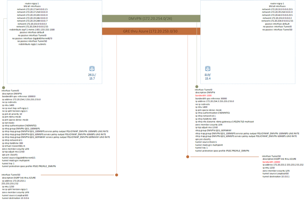

I think I'm fundamentally misunderstanding how EIGRP works, so I need correction.  The more I learn, the less intell-a-ma-gent I feel...
I have an HQ HUB router with two equal cost/metric paths to a branch.  Primary path is DMVPN over public internet.  Secondary path is GRE running over Azure VPN transport.
I want to control the route to the single branch without effecting other branches on the DMVPN.  That means no changing values on hub DMVPN (delay or bandwidth).
Hub interfaces have no changes to default bandwidth/delay.
I thought if I changed the bandwidth or delay on the branch side, it would propagate to the hub for that specific branch network, but it does not change anything on the hub.  One the branch table changes, and one path now wins over the other.  Hub shows two equal paths still.
Question 1:  Does path metric calculation take place on each router independently?  Restated, does each router calculate it's own metrics for a route?
The above scenario shows me I either misconfigured the two routers, or I am not understanding that bandwidth and delay settings don't get propagated neighbors, only reachable networks, and each router calculates it's own metrics?
Question 2:  How should I affect path metrics between a hub and branch without affecting other branches on a multipoint link?
I've been reading about am offset list, is scenario the intended purpose?  Do I need to do an offset list on the hub or the branch?
HUB TOPOLOGY to branch

Richard Burts
There are several parts to this question so let me attempt several explanations:
- for each entry that EIGRP will insert into the routing table it uses a reported metric for that prefix which it learned from its neighbor
- EIGRP then uses its local values for bandwidth and delay and calculates its own local metric for the prefix
- EIGRP then proposes the prefix and metric for insertion into the local routing table
So for Q1 yes EIGRP on each router does independently calculate its own metric
For Q2 an offset list can be used to alter the metric of entries. Offset list could be configured on the hub or on the spoke. It seems to me that it would be more simple to configure on the spoke in your case.
HTH
Rick
