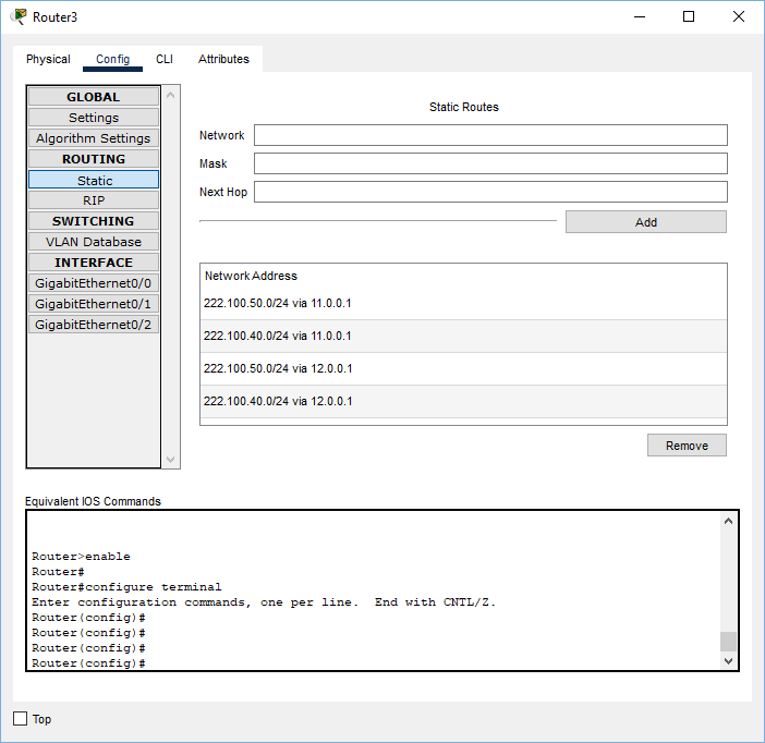

Guys, look, here he has two networks and three routers, but I can't ping the other network, I don't know why, is there any help please?

Frpm which IP address to which IP address are you trying to ping ?
From the first device in the first network, this is the IP address you put in the first router, IP address 222.100.50.1 to the IP address 195.100.40.1 you put in the second router and in the middle router you put these two
there was another duplicate IP address (192.100.40.1, both on the ASA and the GigabitEthernet0/2 interface). I changed the GigabitEthernet02 interface to 192.100.40.2, try and ping again.
Also, ping from PC0 (222.100.50.15) to PC24 (197.100.40.20), that is an end to end connectivity test and should work.
Hey man, even with the new file, I can't ping the devices connected to the wireless router and the devices connected to the other network.
as said before, you need to make sure you are not using duplicate IP addresses. An IP address is like a home address, it needs to be unique. On Router2 you have:
interface GigabitEthernet0/2
ip address 198.100.60.1 255.255.255.0
duplex auto
speed auto
The wireless router has the same IP address, 198.100.60.1. You need to change either one.
