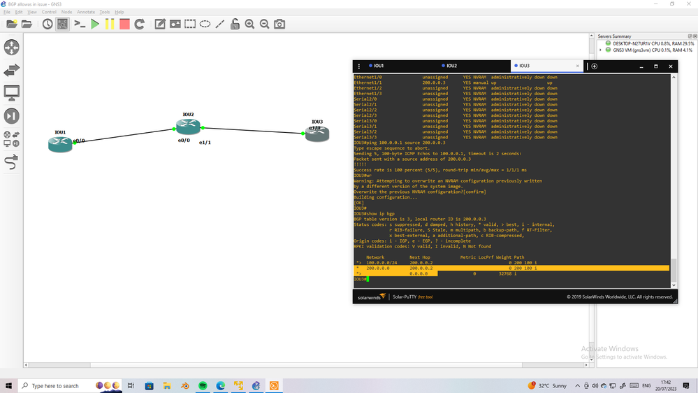

BUT this design have two issue
1-
we advertise the LINK between BGP neighbor via BGP, this I dont recommend AT ALL and for any case avoided it
then how can I test config
config LO in R1(IOU1 in my lab) and R3(IOU3 in my lab)
advertise these LO and test ping between it
2-
allowas-in we use this feature in VPNv4 super backbone, but here it make LOOP
how I know there is LOOP
if we check show ip bgp
we see 200.0.0.0 (subnet between IOU2 and IOU3) have two path
one with next-hop 0.0.0.0 that OK since we advertise this subent via BGP (point1)
other via IOU2 which I dont run any network command, so from where ? 200.0.0.0 is advertise by IOU1, this LOOP and unpredictable behave.
