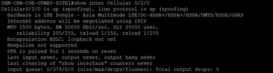

I am using 1121-4P with LTE Dongle.  The version is 17.06.06a.  I am using this as a SDWAN cEdge device.
When i am connecting the USB LTE dongle, i am seeing that the interface is coming up and negotiating the ip address. But the assigned ip (i am seeing the ip in the output of "show cellular 0/2/0 connection") is not reflected in the show ip interface brief output and also the interface status is "spoofing"

The below image shows that there is no ip address assigned

 I believe you can not see the IP due the method used IPCP and when the interface is in DHCP mode, you dont see the IP using this command. . But, you need to rely on the information you receive on the output of "show cellular 0/2/0 connection".
