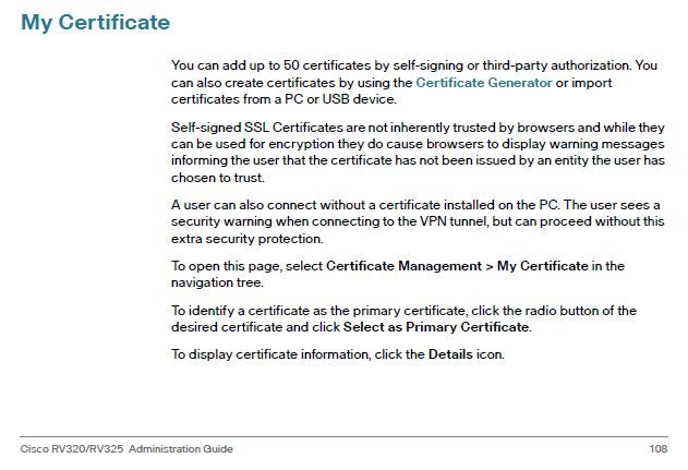

I tried to create a certificate to be able to connect to the router using https. The manual describes that browers may issue a warning.
