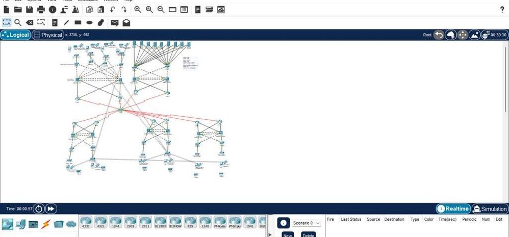

I am new to Wireless Networks please help me with project. I am struggling with correctly constructing my network diagram.

I believe you can check this if the lecturer but I think it is ok to represent with one PC, surely dont make sense use too much PCs, this makes the topology  difficult to handle and PacketTracer crashes sometimes when we overload the devices.
 About the question two, well, if the requirement is wireless I believe you should use wireless.
No, end devices only and Access Points. The infrastructure will always be cabled network.

1. Is it okay to represent the 100 users with 2 pc then on each department add dhcp server
2. Since the lecturer said it must be a wireless network  must I only connect the end devices (pc, printers and phone) wirelessly or it must be everything
wireless on the end devices(pc, phone and printer) only ? or the whole network
