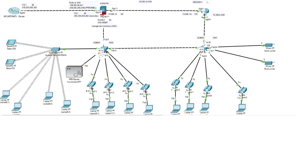

NEW ASA5516-FTD-K9 and I need to add in my topology
amralrazzaz
Level 5
Level 5
I HAVE  NEW ASA5516-FTD-K9 and I need to add in my topology
my current equipment's that i have now as below :
I have cisco catalyst 2960 x 24 gige poe 370w 4x1g sfp lan base  qty. is 2 switches /
Cisco CISCO2911/K9 ( CISCO 2911 VOICE BUNDLE PVD 3-16 UC LICENSE PAK FL-CUBE 01 / Cisco 4 port voice interface card - fxo (ehwic) / Cisco SMARTNET 8X5XNBD Cisco 2911 Voice Bundle )   qty. 1
According to the design I have currently (the network design attached please have a look)
So my questions as below :
  • Where should I put in the the network ? (ASA)
  • What kind of configurations should be removed from router 2911 ? and what should be added?
  • What kind of configurations should be added on ASA ?
  • how to setup and configure ASA such as ( dhcp relay agent-nat-site to site vpn-defualt route-static route -ACLs ) using gui
find the attached config file + the nw layout
thanks
amr alrazzaz

The main question is, what do you want to achieve with the firewall?
i were bought firewall already and according to my current nw diagram now i need to add this FW to my network and need to configure it
my router 2911 is currently manage every thing according to the attached config file
so my question where to add in my network ? is it ( isp---FW---ROUTER----SWITCH )?
also what kind of configurations that i have now on router should be removed and what should be keep and what should be added ?
also in FW what kind of configurations should i add according to the config file i have on router ?
in firewall i need (site to site vpn which is currently configured on router - NAT - ACLs - default route - static route - dhcp relay agent ) and what else ?
all these according to what i attached which i currently have it now !!!
amr alrazzaz
I would place the firewall at the edge of the network. In that case, all the services such as NAT, ACLs, VPN, routing, etc should be moved from the 2911 to the firewall. Basically, the 2911 would become the voice and data gateway to terminate voice traffic which should be allowed through the firewall, and to route the data traffic between the internal and the external world.
Using the UI on the new firewall would be dependant on the code that you will be using on the new firewall. If you are planning to use ASA code then ASDM will be the UI option. However, if you are going to use FTD code, then you would have two options, one is the FDM which allows you to manage the new firewall locally, and the other is via FMC. In case of FMC, it needs to be installed at somewhere such as ESXi or Azure, then you need to register the new firewall to the FMC before you can get started with the ability to deploy configuration. In your case, I think FDM would be enough.
ill use FDM because it will be managed locally for now ??
also as u said i should remove all what u have mentioned from router and reconfigured on ASA ? so i need to know how to configure these via GUI because this is 1st time to manage firewall ... if u have link of how to configure what u mentioned on ASA would be appreciated >>>
also ASA will be between ISP and router ?? if im correct ?
amr alrazzaz
Correct, FDM is free, you don't have to pay any extra to manage your firewall. However, FMC is not, you need to purchase the licenses which I believe it is not cheap.
You might find some posts on my blog useful, although the majority are more FMC focused, but take a look please:
https://bluenetsec.com/blog/
Yes, the firewall will be at the edge of your network, facing to the ISP externally and to the 2911 internally. Here is the Cisco configuration guide for FDM, give it a try, and if you want some help with some specific task let us know:
https://www.cisco.com/c/en/us/td/docs/security/firepower/660/fdm/fptd-fdm-config-guide-660/fptd-fdm-s2svpn.html

Given the network topology shown in the diagram I believe that the logical place for the new ASA/FTD would be between the 2911 router and the ISP. As you implement the ASA/FTD I believe that you will want to move the address translation from the router to the ASA. I would also suggest moving the VPN site to site from the router to the ASA. (it is possible to leave the site to site VPN on the router if you configure port forwarding on the ASA for theVPN traffic. But I see little benefit in doing this and it does complicate the ASA configuration. So my suggestion is to move the VPN to the ASA.)
You have a number of vlans in the network with inter vlan routing done on the router. I suggest that you leave inter vlan routing on the router and not move it to the ASA. You have configured DHCP processing on the router. I suggest that you leave those on the router and not involve the ASA in any of that processing.
There is extensive configuration on the router for phone processing. Certainly that remains on the router with no changes.
Based on the posted configuration of the router I have these comments:
- I note that you have configured both enable secret and enable password. If enable secret is configured then enable password is ignored and has no effect. I suggest that you remove enable password from the configuration.
- I note some configuration for vpdn but do not see where it is used. I do not see where the introduction of ASA/FTD would impact this and wonder if you might want to remove it.
- there are several configuration entries on the router for crypto parameters. If you are going to move the VPN from router to ASA (as I suggest) these should be removed from the router and configured on the ASA.
- on the router there is a crypto map configured and applied on the outside interface. This should be moved to the ASA.
- there are multiple subinterfaces on the router for the various vlans. For the most part they should remain, but the ip nat inside should be removed from them (assuming that you will move address translation to the ASA.)
- the config has a subinterface configured for the primary ISP (G 0/1.328) and there are several aspects of this to consider
* this subinterface has a public IP configured. This address should probably move to the ASA.
* this interface has a secondary address configured. I am not clear what is the function of this secondary address and not sure what should be done with it. Perhaps it becomes the primary address for the interface?
* if the primary IP address (the public IP) is moved to the ASA then a different private IP should be configured for this interface. This address should be in the same subnet as the IP address configured on the ASA inside interface. Perhaps it would use the 172.19.138 subnet?
* this interface is configured with access-group to apply an access list to filter traffic, especially to deny SSH access. You might keep this access list, but this filtering should now be done on the ASA. I would also note that this access list is fairly complicated with entries for each of the interface addresses on the router. It would have been much more simple to have configured a standard access list permitting the subnets allowed to SSH and applied it using access-class on the vty ports.
* this interface is configured for address translation and with the crypto map for the site to site VPN. Both of these should be moved to the ASA.
- the config shows that G 0/2 is for a secondary ISP. It is currently shut down and not operational. It is not clear whether there are plans to activate this, and if so, what changes it might require on the ASA.
- the nat pool and the nat translation should be removed from the router and configured on the ASA.
- the router has a default route using this next hop
172.19.1x8.8x
where the last octet does not quite match the configuration of the interface which has 9x as the last octet. I assume that this is just a typo and not intentional. Depending on what you decide to do with G 0/1.328 the next hop for the default route might change.
HTH
Rick

hi Again
i have attached ye new design after added the ASA and i need to know the below please:
- is the ASA place is correct ?
- for the management port on ASA i connected directly to switch so is that correct ?or it will make a loop?  how it should be configured ? only put an ip address from the management vlan i have and remove that cable or it should be existing to access the ASA ?
- i have like 11 vlans and all created on router (sub i/f). i already configured on router for each sub i/f ip helper address, so how to configure it on ASA for each vlan ? ( flexconnect ?)  shall i keep the dhcp configurations on router ?? is it fine ?
- for the public ip address i have on the router i/f faced to isp public ip and secondary ip so is there availability to configure same on ASA i/f faced to isp ?
- where should i configure ACL ? shall i keep on router or remove and make it on asa?
note: i dont have isp router ,, im just asked them to put the service on the network cable directly sdsdsd.png
amr alrazzaz
hi Again
amr alrazzaz
amr alrazzaz
I believe that the placement of the ASA is appropriate.
I would not connect the management interface of the ASA to one of the switches. I would have all traffic between the ASA and your internal network go through the 2911 router.
I would keep the 11 vlans, their vlan interfaces, and inter vlan routing on the router and would not attempt to move any of that to the ASA. I would leave the DHCP on the router.
I would suggest that the router is already routing between the vlans and would not change that. There is no need for any traffic from one part of your internal network to go through the ASA to get to another part of your internal network. I would configure a static default route on the router with the next hop as the IP address of the connected interface of the ASA. (I am having difficulty seeing the addressing but it appears to be in the 10.246.14 network?) So the router would forward all outbound traffic to the ASA. You probably will want to configure static routing on the ASA for all of the internal subnets so the ASA will go through the router to get to all of the internal subnets. Or you might consider implementing a dynamic routing protocol between router and ASA for the internal networks.
The drawing shows the ASA outside interface with a Public IP address and a Private IP address as secondary. I do not believe that this will work on the ASA. I still would like better information about what the service provider said about the IP addresses but believe that you will probably want the Private IP as the interface address and use the Public IP for address translation on the ASA.
There is a mention of vpn tunnels on the ASA. This would be appropriate (to move them from the router).
HTH
Rick

Actually, I don’t know why I have to configure 2 ip on wan interface?
Shall I ask isp to provide me only the public ip address and no need for 2nd one because it will not be using on ASA ?
I have like range of public ip address ( 6 public ip) so how to use same I currently now having on router 1 public ip for vpn and another one for nat traffic?
Or can I use only 1 public ip and separate between vpn traffic and nat (translations internet) traffic? and how to make this on asa after removing from 2911 ) ?
Also how to block traffic from wifi guest vlan to my internal private resources using ACL ( which am currently using same now on router )
Ill move the ikve2 vpn from router to ASA
thanks
amr alrazzaz
