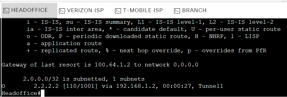

Hi Team,
Can anyone tell me why OSPF not showing in routing table but shows in show ip ospf database.
Can anyone help me to fix this issue?
FYI I thought that OSPF not showing because lower AD value is there with default routing.. I changed to 200 but it did not work

Hi @ankitohc ,
The only interface on which you enable ospf is the tunnel and this route is already known as a connected route in the routing table on both Headoffice and Branch.
Try enabling ospf on another interface, such as gi0/1 on Headoffice and you will see that route as an ospf route in the Branch routing table.

Hi @ankitohc ,
Or you could just add a loopback interface on both Headoffice and Branch and add these interfaces to ospf.
Headoffice:
int lo0
ip address 1.1.1.1 255.255.255.255
router ospf 4
network 1.1.1.1 0.0.0.0 area 0
Branch:
int lo0
ip address 2.2.2.2 255.255.255.255
router ospf 5
network 2.2.2.2 0.0.0.0 area 0
Regards,
Regards,
thank you it worked I see the OSPF in routing table I have one more questions.. Can't we configure redistribution for connected routes, I mean is there any I can see the OSPF in routing table for tunnel interface
