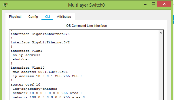

this small LAB
one L3SW in middle connect to two router,
i config the both case using VLAN and using router port.

As i mention, both pkt and gns3 have some limitations.
In your case l3sw need vm to work the local host gns3 with sw image not work.
