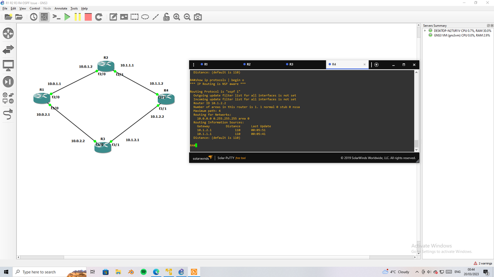

Hello Professionals,
I was doing some testing for OSPF with packet tracer for a topology of 4 routers. R1,R2,R3,R4. When I issued the command "show ip protocol", the output of the command showed the results shown in the attached photo. As you can see in the routing information resources, the gateways are (1.1.1.1 which is the R1 router ID), 10.1.1.1, 10.1.2.1 and 10.1.2.2. Are these readings legit?...Is it normal to see the router ID listed in the Gateways part?... Any guidance or help would be so much appreciated. Thanks in advance!

I run lab and I see correct value, so I think it is bug in packet tracer.
Screenshot (415).pngScreenshot (416).pngScreenshot (417).pngScreenshot (418).png

yes, OSPF uses Router ID to indicate your neighboring OSPF router.  Maybe you confusion comes from work of "gateway" which in that particular output means your next door neighbor.
Also, notice same IP will be used in show ip ospf neigbor
Regards, ML
**Please Rate All Helpful Responses **
@Martin L I think the confusion came because I issued the "show ip protocol" command from R1, and the router ID issued in the Routing Information Resources part (Gateway) was 1.1.1.1 is also for R1. Thanks Martin L!
MikeNY85
oh, right, that Gateway info "1.1.1.1" should not be there in R1 output if and when R1 has 1.1.1.1 IP or router ID.
Nice catch !
Regards, ML
please share the config of all four routers
I will check this issue, update soon
MikeNY85
@MHM Cisco World here are the configurations for all 4 routers.. notice that the loopback add which is going to be the router ID for R1 was also showing on the "show ip protocol" from R1. I just want to confirm that this could be a glitch with packet tracer.
Thanks very much in advance!
Looks to be a bug. Could you save your work and restart all devices to see if that clears the issue?
