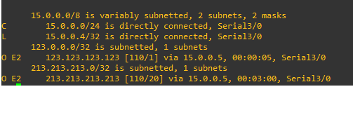

let explain the issue here, the network (Link) can not config under both process, so here we config network under OSPF10 (the OSPF process connect to MPLS SP) and then redistribute OPSF10 into OSPF15
so the prefix through interconnect will appear as E1/E2 (E1 or E2 depend on your config).
the idea is better than my idea of use GRE.
in my lab I config LO 123.123.123.123/32 config it under OSPF10 and then redistribute it into OSPF15
when the MPLS SP link to R4 is down the R4 add this prefix into RIB as E2.
NOTE:- the redistribute with route-map I only redistribute the prefix need to send via interconnect, the Link between Site's and MPLS SP no need to redistribute it to other Process (prevent routing LOOP)
please ask any Q in your mind, may be there is some detail hidden for me.

NO this is GNS3,
why use route-map?
we must prevent prefix learn in Site1 from MPLS and redistribute into other process and advertise to other Site2 to redistribute again into MPLS.
that it.
