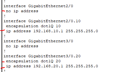

First, configure IP add ont the sub Int ; for example on Router R-BLOK-0:
Ping between laptops from engineerig to Administration should be OK (left side)
Other things, you can not have same IP ADD
(i.e. 192.168.10.0/24 - vlan 10)
on different routing segment. It should not work, you'll need to stretch vlan 10 (L2VPN).
You can have same vlan ID because it is a local ID, but on your context you should do subnetting -- subnetting the IP ADD for Engineering subnet and administration subnet. For example:
R-BLOK-0: vlan 10 - Engineering 192.168.10.0/25 and administration 192.168.20.0/25
R-BLOC-N: vlan 10- Engineering 192.168.10.128/25 and administration 192.168.20.128/25 (keep same for vlan 30 and 40).
On R-BLOK-0 side no need to have sub int for vlan 30-40! Same idea on R-BLOK-N side.

Delete SVI on you L2 Switches. For example, you have on the left side, engineering vlan,
IP add 192.168.10.1/24 on the Sw
and on the R-BLOK-O too!!!! Let's this IP on your L3 equipement, such as R-BLOK-R ; it serves as Gateway also for your vlan!
Why you wan SVI on your L2 switch? The only one should be an SVI for management purpose!
I delete on SW-BLOK-O-1 SVI and ip default gateway
LAPTOP can ping its Gateway hosted on R-BLOC-O
I delete also SVI on S-BLOC-O-2 and now vlan 10 ping vlan 20 on left side !
Best regards

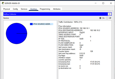

Thanks a lot! It works now, for practical purposes, laptops under VLAN 10 can ping the server.
I also adjust the switch where as the router are connected to VLAN 10 too. Actually, the router is used for NetFlow configuration.
I have done the router R-SDEC settings
 ip flow destination 192.168.10.1 . Also, ip flow ingress and egress for Gig 3/0 R-SDEC
I can ping 192.168.10.1 (the server) and 192.168.10.2 (the router R-SDEC) from LAPTOP-0-01 under VLAN 10.
But there is no any output when I use the server's NetFlow app. If the server's NetFlow app got output, my whole assignment is complete.
How to fix this? Latest
.pkt
file below.
Thanks a lot in advance.
@syazwanmarzuki,
Adujst neflow configuration on R-SDEC:
You will have sample on netflow configurator on SERVER-MAIN-01:
Follow this for netflow config.:https://www.packettracernetwork.com/tutorials/packet-tracer-netflow.html
Best regards
