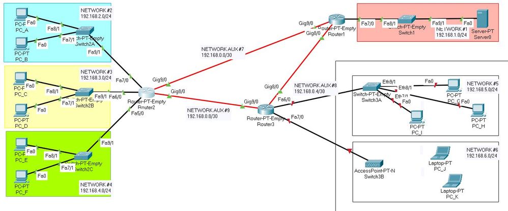

I am quite new to this world and I'm currently to understand why an ICMP ping is always sent to the same PC.
In this case, I am sending a ping from PC_F to Server PT. ping 192.168.1.2 In the simulation, the message goes always to PC_C, which IP is 192.168.3.2 Looking in more detail on Router 2, the static routing shows:
  • 192.168.5.0/24 via 192.168.0.10
  • 192.168.6.0/24 via 192.168.0.10 olehana arabic
  • 192.168.1.0/24 via 192.168.3.2
At the moment Network #5 and #6 are not connected, but they will.
I am not sure if the static routing should be the following:
  • 192.168.10 / 255.255.255.0 / 192.168.0.0 (to server)
  • 192.168.5.0/ 255.255.255.0 / 192.168.0.8 (to network #5)
  • 192.168.6.0/ 255.255.255.0 / 192.168.0.8 (to network #6)
Am I missing the routes to Network #2, #3 and #4?

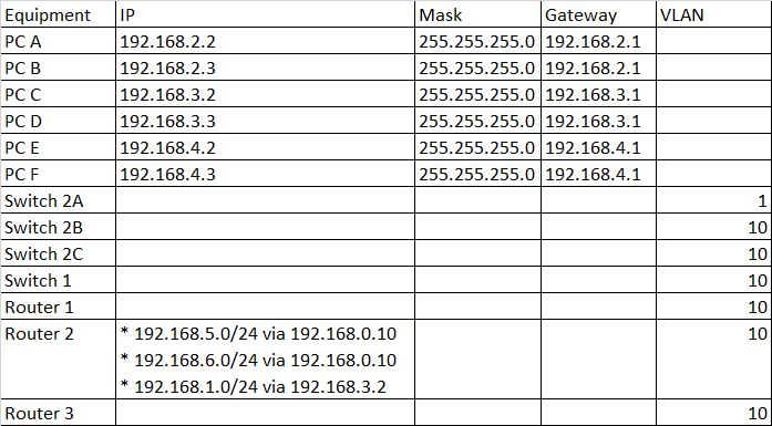

Here I add a table to sum up the IPs, Masks, GW and VLAN:
 Thanks for Your suggestion/Correction.
balaji.bandi
because of this static Route  " 192.168.1.0/24 via 192.168.3.2" as per the description, not sure what is goal or task,
Not sure what is the IP address of Router1, you need to change the static route to wards router 1
  • 192.168.1.0/24 via 192.168.x.x  ( x.x - Router 1 IP address).
