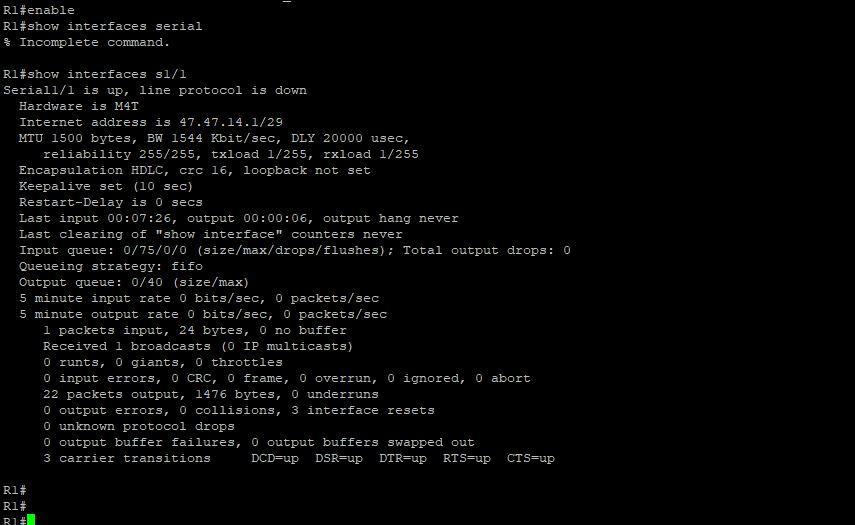

the serial interface that the 'clock rate' needs to be configured on should be DTE. Check whether it is DTE or DCE with the 'show interfaces serial' command...
Actually its DCE. So how should i change it?Screenshot 2024-04-03 002338.png
