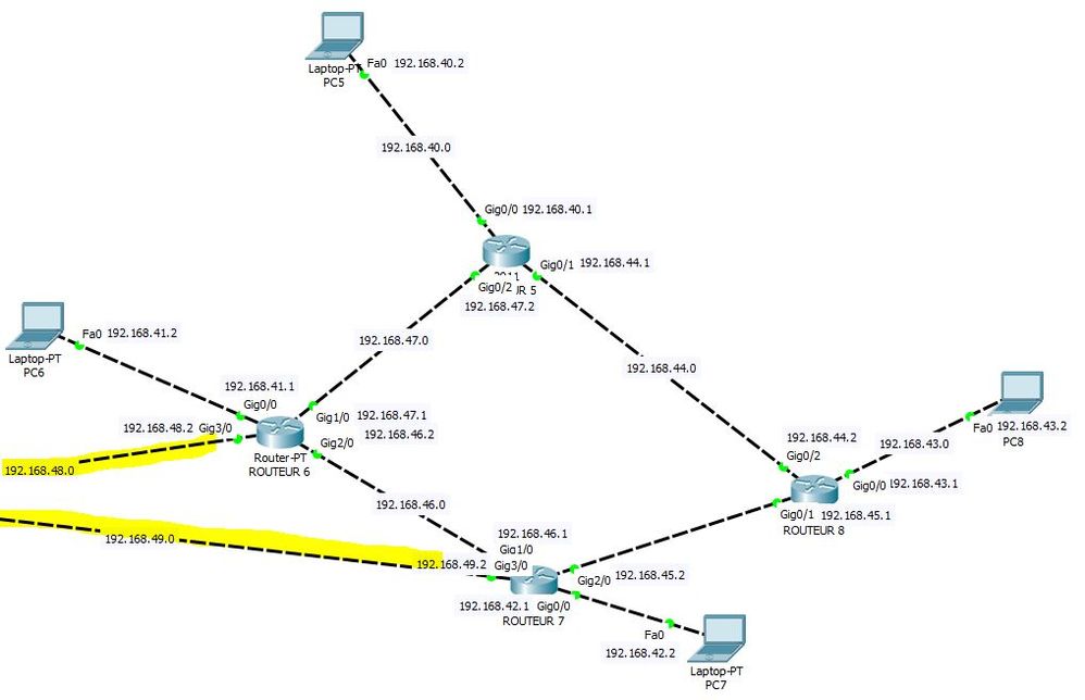

Till there, everything is fine and all PC wihtin one network can ping each other successfully. I've simply used the following command to configure the RIP v2 for each router (example provided for the router 1 - the things between bracket, e.g. (ou conf t), weren't used):

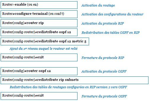

To interconnect the two networks, I've added two central routers assuring the role of redistribution as shown below:

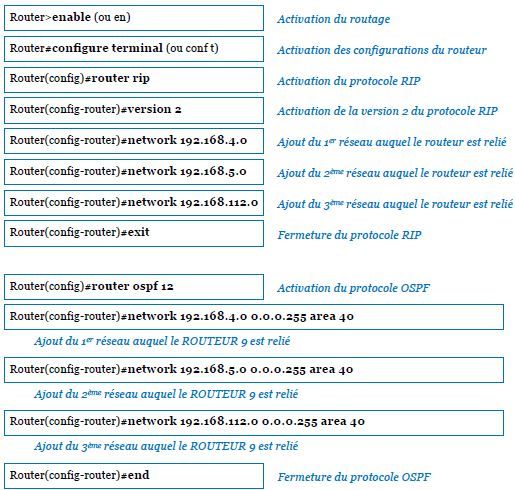

I've used following commands to configure these routers in both mode (RIP v2 and OSPF) as well as to lauch the redistribution:
ROUTEUR 9
ROUTEUR10

Hi
First of all, just to recap, OSPF AD is 110 and RIP is 120. A router will always prefer the lowest one, then OSPF.
Usually, in real word, to avoid that type of issue, you'll:
  • Tag RIP routes when redistributing them into OSPF
  • Use route-map on RIP to deny this tagged subnets when redistributing OSPF into RIP.
These are recommendations and best practices when dealing with redistribution inter protocol and you need to take care of different AD to not do any loop.
Now in your design, you have RIP and OSPF configured between R9 and R10 and redistribution is done on both routers (R9 and R10) for both protocols. Based on protocol decision, OSPF will be preferred.
I don't see why you configured RIP on R10. R10 should be part of your OSPF world and R9 will be part of the 2 worlds.
The router doing the redistribution would be the one at the border of each world and that can be R9 or R10 but not both.
Also, you can deal with tags to limit that if you really want to have redistribution on both routers (again that's useless) but Packet Tracer isn't able to deal with redistribution and route-map where a real router will allow you such thing. Doing that will also complicate your design and that's not needed.
To solve your issue, remove the redistribution on R10 and also your RIP as it's useless. R9 will be kept as is with all redistribution and everything should work as expected. This is a solution.
As you can't deal with tag, you can modify the RIP AD lower than OSPF, let's say 95 and you would apply the following commands (it will set AD to 95 for routers coming from both R9 neighbors)
distance 95 192.168.4.2 0.0.0.0
distance 95 192.168.5.2 0.0.0.0
But the solution and simple one in your design is to remove R10 from RIP domain and redistribution as well from R10.
