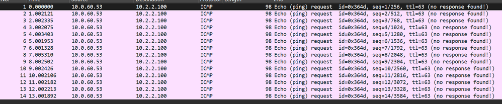

So I have a PTP S2S IPSEC tunnel created for a location I was able to get the connection up I can ping all the Endpoints in the route okay on both sides. However I noticed connecting to RDP or doing SMB it was SLLLOOOOOW. Or just disconnected due to timeout. I thought maybe it was the DNS. But the dns was reaching but noticed that was having a delay in name resolution.
So then I got down the rabithole of inspecting the packets and doing ping with packet size. I tried with paramters -f and -l. I tested what my largest acceptable packet over IPSEC and noticed that it taps out around 1410. On my FTD the WAN that is connecting the Firepower/Tunnel is set at a MTU of 1500. The extranet device has MSS Clamping with TCP Connection Segment size of 1452 and the MTU is 1500.
I have a feeling it all has to do with the MTU from my readings but if someone thinks other wise I am all ears.
Now to fix Is this something I have to do via the Flexconfig to fix? I read something about adding sysopt_basic. However it looks like it will size all tcp traffic, should I configure to only to size the IPSEC routes only? Also what is the recommended MSS TCP segment size for MTU of 1500 over IPSEC?
After support calls with cisco and ubiquiti. I took another glimpse. Turned out to be LACP config issue. I thought LACP On in cisco world meant LACP negotation. My Switching LACP to active corrected everything crazy stuff literally a dropdown.

Now we are reversing roles
I am going to ping from the host 10.0.60.53 -> 10.2.2.100 same thing in FMC I setup a capture and reversed setting in there and the setup the dump on my extranet router.
To my surprise on the extranet router I got no reply!
But did the FTD see it and acknowledge it?
It did see my ping request and kick that packets to the wind. So where does that lead me? Why is some IPs ping completely fine while some arnt. Why when connecting to services even with the interface and ips trusted does it seem like its dropping packets.
So here is a healthy ping 10.0.60.52 -> 10.0.0.2. Same subnet same acp rules everything just different machine on the extranet side.

Now to answer your question above. Yes it Does here is the proof:
From CLI of the FTD:
Interface Ethernet1/1 "ISP-WAN", is up, line protocol is up
Hardware is EtherSVI, BW 1000 Mbps, DLY 10 usec
Description:  ISP
MAC address 8c94.6138.67a4, MTU 1500
From Packet Capture:
Frame 1: 98 bytes on wire (784 bits), 98 bytes captured (784 bits)
Ethernet II, Src: JuniperNetwo_ae:08:02 (40:71:83:ae:08:02), Dst: Cisco_38:67:a4 (8c:94:61:38:67:a4)
Destination: Cisco_38:67:a4 (8c:94:61:38:67:a4)
Internet Protocol Version 4, Src: 10.0.60.52, Dst: 10.2.2.100
Internet Control Message Protocol
I appreciate your guidance a lot. I have one more day of picking this thing apart and if still throwing me issue this getting to be TAC worthy. The Sonicwall and Ubiquiti gear I have in place are rock solid this been little bumpy for some reason.
