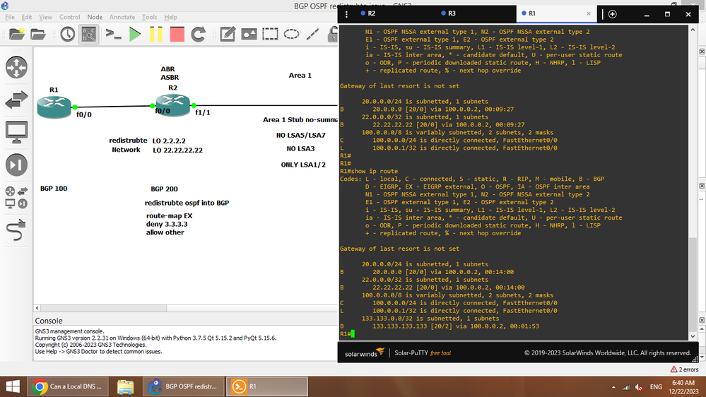

there is no conflict I make double check and the result as you see
LO 3.3.3.3 is not advertise
(LO in R3, R1-R2 BGP, R2-R3 OSPF)
LO 33.33.33.33 is advertise

I think area 14 range 10.200.0.0 255.255.0.0 is the culprit which advertises summary route. in my case summary route is getting adverised at this point.
friend you must careful
area Stub and no-summary
this mean that the area is not accept
LSA3 nor LSA5/LSA7
i.e. the redistribute will not work nor the LSA3 from other areas
you can use network command to inject the prefix into the OSPF which add it as L1 and then redistribute it into BGP
below lab show you two router in area 1 stub no-summary
some Lo use redistribute and other use network, check which appear in R1 (BGP 100)
Goodluck
MHM
