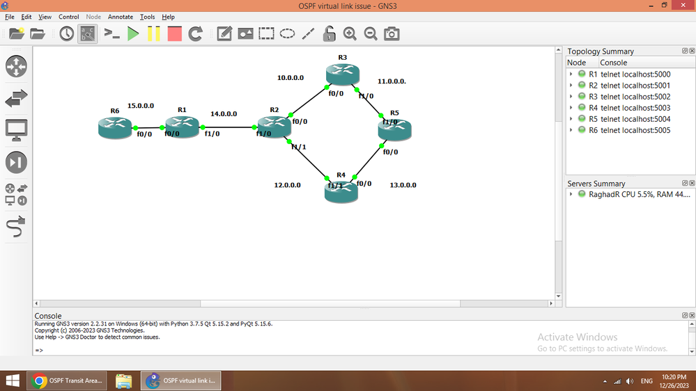

the R2 is ABR between Area0 and Area 1
R3 is ABR between Area1 and Area2
I config virtual link
you can see in R1 the advertise router is R3 not R2 so the rule is correct
Hi @MHM Cisco World ,
Your topology is different to mine.
I have 2x ABR in Area 0. To replicate correctly, you need another router - e.g. R6 - with one link to R4 and another to R1.
Then observe that the link between R4 and the new R6 router is being injected as a Type 3 into the transit area by R3.
Thanks.
Sam
the devil in detail friend
I make another link between R4 and R1 make two ABR router in Area 0
you can see the 11.0.0.0  is now learn from both 3.3.3.3 (virtual) and from 10.0.0.4 R4 but the R1 not consider prefix from R4 even if it in db, the missing of  routing bit set is meaning that R1 not consider LSA3 from 10.0.0.4 in SPF.
MHM
Sam-CCNP
Hi, @MHM Cisco World
The topology is still not replicated correctly.
Sam
