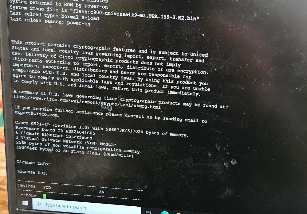

The Strange here is - the one you posted show version shows that the file already in the flash:
and the device booted after power on
the File you trying to copy same file name, why you want to copy if the File already in the Flash ?
Its bit confuses to read screenshot - rather screenshot ( text output - post below output complete)
