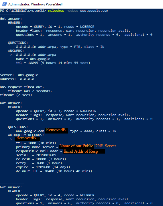

Results of nslookup specifying the server as 8.8.8.8 (also shows dns timeout to internal DNS as client machine is connected to LAN interface GE 0/1
ipconfig /all after setting static dns, of 8.8.8.8 on client machine
Results of nslookup after setting static DNS of 8.8.8.8
Results of nslookup -debug with static dns to google.com (2 screenshots due to output)
Results of nslookup -debug with static dns to www.google.com (I lost the screenshot to the second page unfortunately)
Results of ping with static DNS of 8.8.8.8 to both google.com and www.google.com
in OS do below and share result here
nslookup -debug google.com
