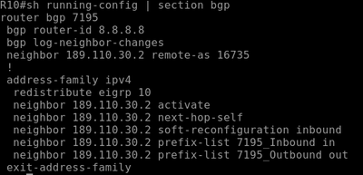

I have the following connection between the router and the firewall:

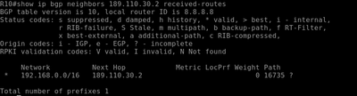

The routes are being received from the BGP peer but are not in the routing table.
Follows the Cisco config:
Does anyone have any idea what the problem is?

Hi @Victor Wardi ,
The inbound prefix-list does not permit 192.168.0.0/16. So the prefix will never make it to the routing table.

I found issue you use in filter
192.168.0.0/24 le 32
Use instead
192.168.0.0/16 le 32
That it
MHM

these prefix have next-hop same as prefix ??
can you show the topology with more detail
MHM
Yes, the FortiGate was redistributing the connected routes. I disabled it. Below is the new output:
R10 is receiving a static route redistributed via BGP from the FortiGate.

the FW send the prefix the router receive it but not inject into RIB
two reason the next hop is un reachable that can not be since the 189.110.30.0 is subnet direct connect FW to R10
the other reason is you have filter with direction IN filter this prefix
MHM
Use instead
That it
MHM
That was the issue. Thank you so much! You have keen eyes.

nguyenbmt106
From R10's show ip bgp summary, it looks like the peer didn't advertise any prefixes (look at "State/PfxRcd").
Second thing is from R10's BGP table, these 2 prefixes are not marked as best, so it will not be added to the R10's routing table.

Hi @Victor Wardi ,
Regards,
Regards,
