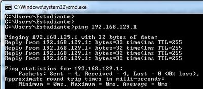

Thanks a lot for the information. Is there any command to enable ICMP in cisco devices? How it works?
Hi @SathishkumarSaravanan0348 ,
The ICM portocolle is enabled by default in most network devices:
PC:
Router:
Regards
