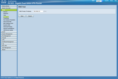

I hope you can help me solve this issue.
I set up the DMZ ip in the rv325 router configuration but it only works if I access it from the LAN. If I try access it from outside the house it won't work.
I have only one subnet 192.168.0.0 and the local ip of the DMZ device is 192.168.0.10.
What can I do to make it work?
Thank you!

balaji.bandi
Do you have static IP from provider or Dynamic ?
what IP address you trying what port ? Can you share your screenshot to understand how you configured.
here is quick view and related setup config for reference :
https://www.cisco.com/c/en/us/support/docs/smb/routers/cisco-rv-series-small-business-routers/smb4166-configure-dmz-host-on-rv320-and-rv325-vpn-router-series.html

Thank you for taking the time in helping me!!
You have a screen shot of the configuration page where I set up the DMZ setting.
I have a dynamic ip from the ISP but I also configured the ISP dynamic dns so it takes me every time to my router from the outside like xxx.go.ro
When I am connected to my wifi and I try to go to xxx.go.ro it opens up the NVR page (my cctv page). When I am on 4G and I try to go to xxx.go.ro it doesn't open the page (The site can't be reached error on safari).
I hope you can give me an advice.
Thank you!
I fogot to include the screen capture
