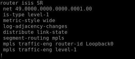

I configured the Policy to choose the path followed by traffic between 100.100.100.100 and 100.100.100.101 but there is a problem

Could you please provide the configuration for PE-SR1 and the output from
show segment-routing traffic-eng topology ipv4?
Regards,
Regards,
Hi Mr @Harold Ritter
config PE-SR1
