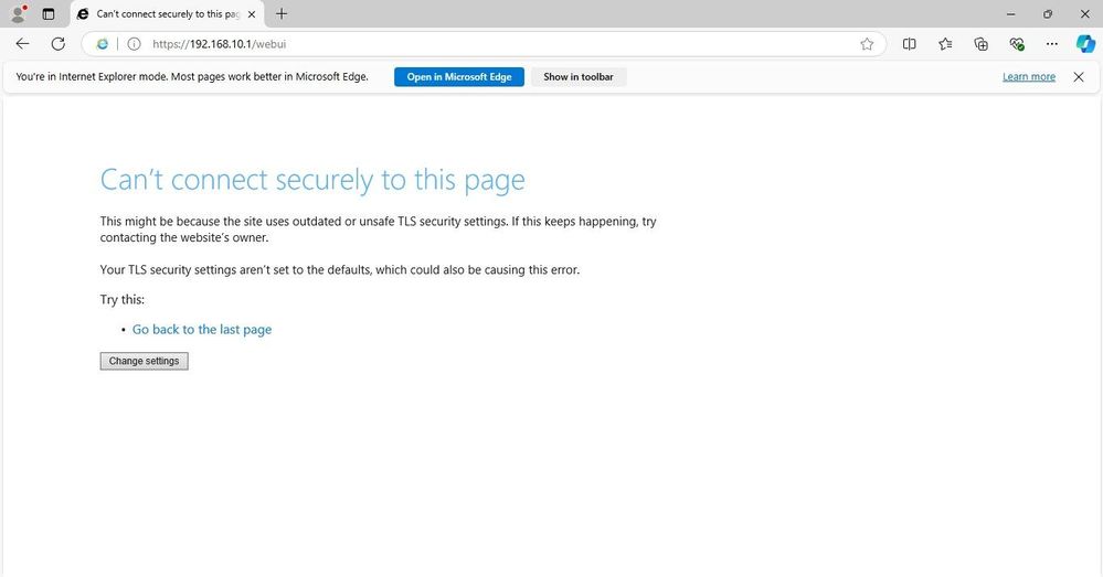

We have a cisco 4221 router. When I try accessing its GUI page on https://192.168.10.1 its not letting me access that.
What all I have tried and not working is as follows:
  1. Tried older version of firefox which supports TLS 1
  2. Tried fiddling with the firefox setting security.tls.version
  3. Tried using internet explorer
  4. Tried changing internet options settings for internet explorer
Please help me with that.
PS: I am not a network expert. I am amateur at it. But I can manage configuration through GUI.

What type of errors you see when you try to access? I believe you also need to specify secure port right after the ip address. This could also be a certificate issue. Can you actually ping this ip? or SSH using the same ip address?
Thank you
These are the screenshots of the three browsers.
I don't think if any port number is needed. How to verify that?
I can ping this IP.

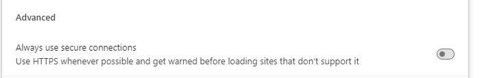

This is how I disabled but it still redirects.
