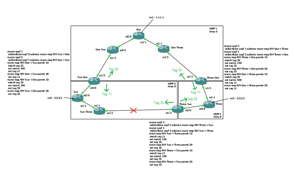

Hopefully this isn't too confusing to look at but I'm playing around with this test topology in GNS3 to get a better understanding of how OSPF works.  DrakoNoo_0-1709068991323.png
My question is when looking at the routing table of router "Three-Two" it sees the loopback 2.2.2.2 from Router "Two" via OSPF2 as an internal route.  If I shutdown the link (red X) router "Three-Two" then sees the route to 2.2.2.2 via the external redistributed route from OSPF1.  Makes sense to me so far except when the link gets re-enabled router "Three-Two" keeps the external route in the routing table and stays that way.  Should the internal route not get put back into the routing table once the link comes back up or is there something that I'm not understanding.

Hello @DrakoNoo ,
what you see is normal because you are dealing with two different OSPF processes and both of them compete for installing a route for prefix 2.2.2.2.
However, the distinction between types of routes intra area , inter area , external routes work only within a single OSPF process.
This is called "ships in the night".
Simply put each process presents a candidate route with AD 110 and a metric to the IP routing table manager daemon that picks up one in case of  a tie on both AD, metric value. The IP routing table manager is not aware that one process has an internal route and the other one has an external route.
For better tuning in  a scenario like yours one OSPF process should act as the core process and the other one as edge process.
In both OSPF processes you can use the following command
distance ospf   <O distance > <O IA distance > < O Ex distance>
the default is 110 for all three , but you can increase the AD for external routes to avoid the competition
Hope to help
Giuseppe

Thanks MHM for the suggestion.  If I set the OSPF2 intra-area distance on router "Three-Two" to 105 the route does fail back and forth properly.

Interesting - I didn't catch that part in the article.  Seems to be exactly what was happening.
 Now, if a route is installed via one process, it is not overwritten by another OSPF process with the same administrative domain (AD), unless the route is first deleted from the routing table by the process that initially installed the route in the routing table.
Funny enough I tried using a different image/router in GNS3 and it did fail over properly.  I guess as mentioned the behavior is unpredictable when configured this way and should be avoided in a real network.
