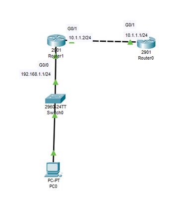

Hi, I've been playing around with DHCP Relay for 2 hours now, just to try and make it work
Router0, is DHCP
ip dhcp excluded-address 10.1.1.0 10.1.1.20
ip dhcp pool FISH
network 10.1.1.0 255.255.255.0
default-router 10.1.1.1
interface GigabitEthernet0/1
ip address 10.1.1.2 255.255.255.0
ip ospf 1 area 0
duplex auto
speed auto
interface Vlan1
no ip address
shutdown
router ospf 1
router-id 1.1.1.1
log-adjacency-changes
Router1,
interface GigabitEthernet0/0
ip address 192.168.1.1 255.255.255.0
ip helper-address 10.1.1.1
ip ospf 1 area 0
duplex auto
speed auto
ip address 10.1.1.1 255.255.255.0
ip ospf 1 area 0
duplex auto
speed auto
Routing is OK. I have ospf
DHCP Pool is OK.
IP Helper is pointing to 10.1.1.1 (aka. Router0 DHCP) on Router1 OK.
What is wrong I don't understand isnt this possible?
your IP helper address was wrong, also the entire DHCP pool. There were also some incorrect static routes.
Attached the revised file.

this what you misconfig,  I correct it
ip dhcp pool FISH
network  192.168.1.0 255.255.255.0
default-router  192.168.1.1
ip dhcp excluded-address 192.168.1.1-192.168.1.x
<<- this also need to change depend on your requriment.
post your zipped Packet Tracer project (.pkt) file...
balaji.bandi
In your network connection, you using p2p address 10.1.1.x /24 network, are you looking to get the same IP address for Clients?
If you looking to Clients to get 10.1.1.x/24 - then you need to change the p2p address to a different IP address with /30
or change the 192.168.1.X /24 as the DHCP pool for the client to work.
if you looking to use 192.168.1.x /24 network as DHCP pool make sure you exclude range as you did for 10.x.x.xnetwork.
ip dhcp excluded-address 192.168.1.1 192.168.1.20
I am sure you have routing good (since we did not see Router 1 OSPf config in the post so)
BB
loienejer
Hi, thank you so much for the answers I'm not sure if I understand. I have posted my little project
I'm trying to make the client get an address from 10.1.1.x/24 pool
friend how you assign IP to client from subnet that you already you use between routers ???
that not correct
the client must get IP from subnet same as subnet you config ip helper under it.
otherwise it never work.
