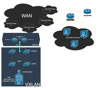

Could you draw the topology example, please? I'll check in lab

Hey.
Sorry for the delay.
Here as requested;
Regards,
M
So, as I see you have BGP both in Service side and Transport side and most probably you advertise public range for VMs to internet providers.
I have checked route leaking between service-side and global (transport side) it worked normal. First you need
You should replicate and redistribute these routes. It works over routing table (so on best ones). Below is an example from my lab:

mdewald
Hello there. Please pardon the long delay.
I've spent the last week to check any other aspect of my setup (beside the routers) to make sure not wasting your time.
In fact, your example made it really clear to me how to handle the redistribution and replication of those routes inside of the routers. After all; This seems to work now!
Thank you very much for the time you spent helping me out! I deeply appreciate that.
