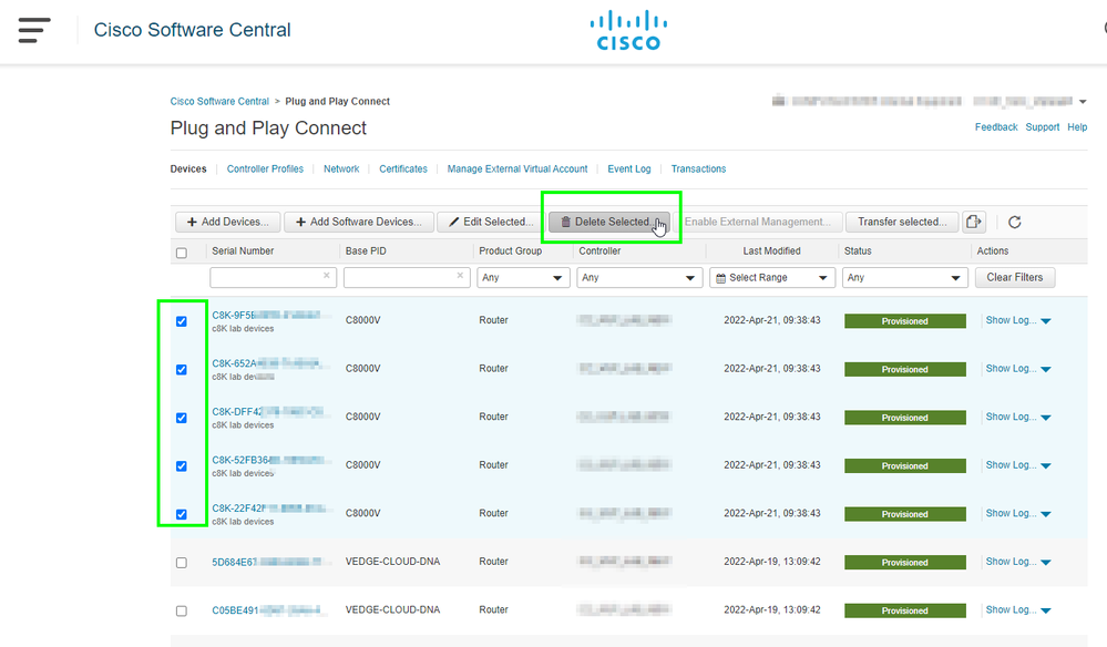

for my lab i created C8000V devices on Plug and Play Portal. Then i downloaded the provisioning file (serialFile.viptela) and uploaded it in vManage ( Configuration > Devices > WAN Edge List and click on Upload WAN Edge List).
When i do that i receive the error: Unsupported chassis number C8000V-C8K-xxxxx from vManage.
But the serial numbers in Plug and Play Connect don't start with C8000V-C8K. They start with C8K-XYZ.........
Now i can't even delete those new created C8000V devices in Plug and Play Portal.
TAC doesn't want to help me since this is a learning lab ...
Please see screenshots attached.
Not able to Onboard a C8000V is bad, but not able to delete the devices/serials from Plug and Play Connect is worse.
Because i need to upload the Serial file with updated CSR1K and vedge devices.
So if anybody has an idea how to delete those C8000V devices would be much appreciated.
Or what am i doing wrong ?

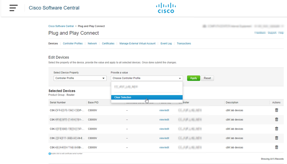

i was able to solve this.
Error 1 (Onboard a C8000V) - This was indeed solved by upgrading vManage. This seems to be not working in 20.3.4
Error 2 (Deleting C8000V device in Plug'n Play Portal): I still couldn't delete it. However, i was able set it to Unconfigured by removing the Controller Profile. See attached pics.
So, issue solved.
