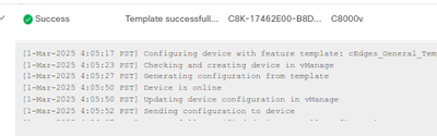

riveraf
vmanage# request nms all restart
That worked for me.
riveraf
Also, stop vmanage/vbond/vmsmart nicely..otherwise you will damage the db
vmanage: request nms all stop  / then poweroff
vbond/vsmart : poweroff
minlawi1992
That worked for me. I just rebooted all controllers except cEdges. Following are the version of controllers and cEdges that I used.
vManage: 20.9.5.1
vBond: 20.9.5.1
vSmart: 20.9.5.1
c8000v : 17.6.1a
