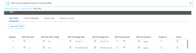

Support for Port Forwarding with NAT DIA from 20.9.1
dijix1990
According to instruction
https://www.cisco.com/c/en/us/td/docs/routers/sdwan/configuration/nat/nat-book-xe-sdwan/configure-nat.html#port-forwarding-nat-dia
Before You Begin
  1. Configure and apply a data policy.
  2. Configure a Cisco VPN Interface Ethernet template or edit an existing Cisco VPN Interface Ethernet template.
  3. Configure interface overload mode. Interface overload mode is enabled by default.
  4. Configure a NAT pool.
And where do I have to configure nat overload and nat pool? Maybe can I do it via cli template?
sorry I missed that topic is for port forwarding. You can configure it if you will specify outside IP address. If you want NAT configuration with interface (NAT to interface), then yes you need CLI template, because in interface template there is no such option:
Below is from my lab. VPN0 interface template:
NAT verification and actual NAT entry after telnet-ing.
From you last configuration only below line requires CLI template, rest of them can be configured on interface template:
ip nat inside source static tcp 192.168.1.100 443 interface GigabitEthernet1 8443 vrf 1
Again, from my lab:
Interface template configured as normal (NAT enabled, dynamic NAT to pool with overload, port forwarding with different IP) and interface template which contains only :
Below is NAT entry and actual NAT entry when doing telnet to 8080 (forwarded to 80):
HTH,

NAT itself should be enabled on outside interface (in interface template). When you enable there is 3 options (interface, pool, loopback) with overload (for pool you may have overload "off" which results normal dynamic NAT, not PAT).
NAT pool is also created within interface template when you choose "pool" option.
But for service side NAT, you do configuration in respective service-side VPN template (in VPN0 template, no NAT config is supported).
Basically, use service-side VPN template for service-side NAT feature ; use VPN0 interface template for DIA feature.
To forward traffic through VPN0 NAT (DIA) you can configure centralized data policy (match ; set NAT VPN0) OR you can have NAT DIA route in your service-side VPN.
Note: if you manage devices via vManage, there is no configuration which is done via CLI. Everything is through vManage.
HTH,
Yes, I did it before, but refer new instruction (only from vmanage 20.9.1 and edge 17.9.1)
  1. Configure data policy (but doesn't say about which action set, nat pool or vpn 0)
  2. You should Enable nat interface (only overload) on the vpn0
  3. Configure nat pool (as we configured overload on the vpn 0 we can't perform it on the vpn 0), so it's on the service vpn
  4. Configure port forwarding on the vpn0 (because if we refer to instruction only there we have option "Source VPN ID"
And, we have cli example how we can perform it via cli feature
Again, from my lab:
HTH,
