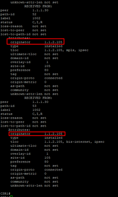

when i add the sequence 18 the behavior changes
Now the originator matches
cedge#show sdwan omp routes vpn x x.x.x.x/x <<- without data keyword
share it here
