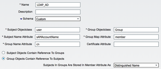

Use CN instead of DN for LDAP group name
When using default LDAP schema for AD within ISE, it will use DN (Distinguished Name) for the group names, which is not easy to read within ISE GUI. This is especially true when trying to use LDAP group in other parts of the ISE such as policies. AD stores group mappings both ways (As in user objects are stored in group as well as group attributes are in user objects) so referencing users from group works as well. If you want to use CN (Common Name) for the group name, create custom LDAP identity store with following settings:
Note: One caveat with doing LDAP lookup of AD is that ISE will not be able to lookup membership of primary group. For instance, all domain users are part of 'Domain Users' primary group, but even though you can map 'Domain Users' to sponsor group, ISE will not be able to match using LDAP. This is due to how AD treats primary groups differently and can be avoided by using other groups or native AD integration.
