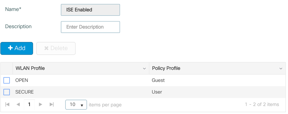

Step 8: Create Policy Tag
  1. Go to Configuration > Tags & Profiles > Tags, under Policy Click Add
  2. Enter Name: ISE Enabled
  3. Within the 'ISE Enabled' Tag window, click Add to map following WLANs to matching policy profiles. This ties the WLAN to the respective Policy Profile.
    WLAN Profile Policy Profile
    OPEN Guest
    SECURE User
  4. Click Save & Apply to Device
