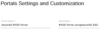

Step 5 – Configure the BYOD Portal
Navigate to Work Centers > Guest Access > Portals & Components > Guest Portals. Create a new Sponsored Guest Portal or select an existing one.
Input the Portal Name and optional Description.
