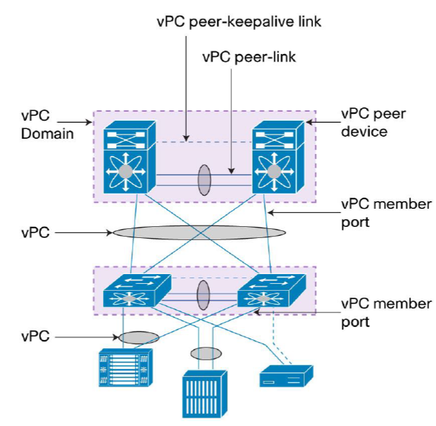

Building a vPC Domain: Guidelines and Restrictions
To build a vPC domain, use the following configuration guidelines:
● You must enable feature vPC (conf t; feature vpc) before you can start configuring a vPC domain.
● You must configure peer-keepalive link before peer-link in order for vPC system to come up.
● You must configure both vPC peer devices; the configuration is not sent from one device to the other.
You need to configure a separate  interface for vPC peer keepalive, below some recommendation:
Recommendations for vPC Peer-Keepalive Link Configuration
vPC peer-keepalive link is a Layer 3 link that joins one vPC peer device to the other vPC peer device,
