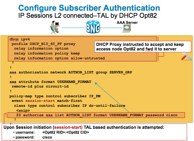

Example TAL (Transparent Autologon) use case 1
TAL or transparent autologon is one of the most commonly used access scenarios for IP sessions.
You can authenticate the user on mac address or option 82 information. The following use cases depict on how to set that up with the ASR9000 BNG implementation.

    One key action in the control policy is obviously the authentication.
    These can be executed via the command under the event/class:
    • 10 authorize aaa list default identifier source-address-mac password cisco
    • 10 authenticate aaa list default
    Both of these will trigger a RADIUS access-request message, but the difference between the two is with the authorize statement we can compose the username ourselves regardless of what is received on the line, where as the authenticate statement uses the PPP chap or pap username and password received. The authenticate option for that reason only applies to PPP based sessions.
    You can define the username in the authorize statement either inline as per example above or you can construct the username via a "formatted" way:
    Note that an authentication does NOT have to succeed in order for BNG to bring up the session.
    The activation of a dynamic template will create the subscriber interface regardless of the authentication result.
    A failed authentication will result in an unauthenticated state and you'll be able to apply HTTP-redirect or restricted access on the session.
