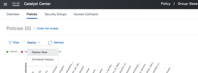

Guessing based on experiences with other users: after changing Group-Based Policies don't forget to "deploy" from either from the Catalyst Center UI or ISE UI.
