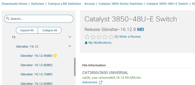

This is actually 16.12.9. I dont' know why the version is calles 16.12.9 but the file is called 16.12.09:
