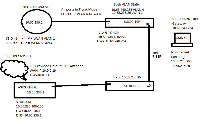

Hello Cisco community! First time post, I'm sure someone can help me with this problem of configuring something that should be simple but has eluded a solution for a week now. I've attached a very rough diagram of my topology and hopefully enough information to help you. I am setting up a guest network and access point and have searched & read many, many posts, blogs, howto's and cannot get this to work. I have two SG300-10P switches in two different buildings connected via fiber. The switches are at the latest version firmware. The Netgear WAC510 supports VLANs and I have two SSID's setup, one on VLAN 1 and the guest SSID on VLAN 4.Both switches are in layer 3 mode, I created Interface VLAN 4 and setup DHCP for VLAN 4. DNS on the switch points to Router. As it should, connecting to SSID 1 results in internet connectivity. The issue is SSID 2. Connection to it results in no internet. The Guest PC gets an IP of 10.65.240.100, GW is 10.65.240.254, DNS is 10.65.240.254. Guest pc can ping 10.65.240.254, 10.65.236.26 but nothing else. As I've read, I need a static route and the switch should handle all the routing, not needing a VLAN capable router. I tagged VLAN 4 through both switches in testing. I have a static route setup on The ASUS RT-AC87U router but am not sure it's correct. I've tried all three listed, individually but for screenshot had them all listed.  In the running config you can see where I tried adding the other switch as a gateway but it doesn't show up in the static route list. I've tried everything. What am I doing wrong or, does my network hardware not support this? Thanks, I'm looking forward to the solution as I'm sure it's something simple for the community.
Topology

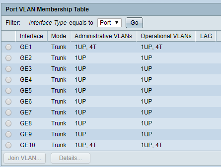

 Static Routes Automatically CreatedStatic Routes Automatically CreatedVLAN 4 DetailsVLAN 4 Details
Static Route Dialog. What is the proper syntax for a route that works?Static Route Dialog. What is the proper syntax for a route that works?
Firmware InfoFirmware Info
Trunking and Tagging InfoTrunking and Tagging Info

Since you are routing VLAN4 on the SG300 you need to let the ASUS router how to reach that subnet (10.65.240.0/24) .
Configure the following on the ASUS:
ip route 10.65.240.0 255.255.255.0 10.65.236.26
cheers,

Bless you Seb! That did the trick! I knew it was something easy but my head just doesn't wrap around the IP routing world very well. I also had to add the router as a DNS server in the Guest network DHCP pool which I had left blank. The test guest PC now has internet access. The guest network will ping the private network. I plan to add some ACL to block the guest network from getting to the private network. Once blocked will the DNS of the guest pool still work when pointing to the router if the router isn't pingable after implementing the ACL?
