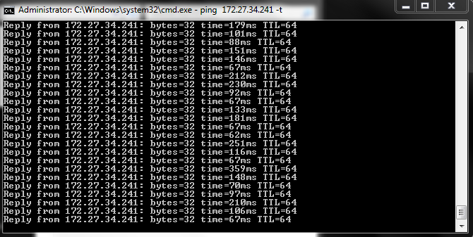

I have 2 brand new
SG500XG-8F8T 16-Port 10-Gigabit Stackable Managed Switches.
However, I am having problems with one of them.
Both have has been configured the same. i.e.
New IP’s
Default gateway
DNS
IP routing configured
SNTP configured
When I run a continuous ping to one of them, the ping times are very slow.
When I ping the other switch it’s OK.
I can confirm nothing else is plugged into the switch other than my laptop.
I have done a factory reset on the switch and it is still has a problem.
I have notice when I reboot the switch it is OK for about 1 hour before the ping times slows.
Please see my attached screen shots.
Has anyone see this error before and how can I resolve it?
Thanks
James

Hi James,
This is really long time. Please double check if those two switches are running the latest boot code. I could also recommend you to test outside the network and perhaps even with default configuration.
Those switches have also show tech-support which may be useful.
It would be good idea to open ticket with Small Business Support team:
http://www.cisco.com/c/en/us/support/web/tsd-cisco-small-business-support-center-contacts.html
Regards,
Aleksandra
Upgraded the firmware and boot code... still had the same issue,.
Turned out to be a faulty switched.
Got a replacement switch and its working like a dream.
Thanks for you help.
James

jlee000011
Following on from my msg above:
I have tried different network cables.
I am patch directly into the switch.
Yes I have enabled IP routing to route across vlans.
Here are the running config of the switches.

For the problem switch to show a running config took 40 mins to print. Its only took seconds for the OK switch to print the running config. Could it be a hardware issue with the switch?
Thanks,
James
Hi James,
Regards,
Aleksandra
James
