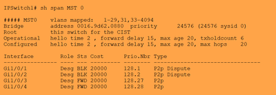

I have configured four switches, two 3750 switches which are root for MST 1 and root for MST 2 (IPSwitch0 & IPSwitch1), the primary root is 24576 and the secondary root is 28672 plus the MST number for all three MSTs (MST 0, MST 1, and MST 2).
Switch0 is a 2960 and has joined the MST region, Switch1 is configured with the same MST configuration but refuses to join the MST region. It has elected itself as the root for all three MSTs:
Switch1 is not receiving any BPDUs on any of the trunk ports to IPSwitch1 or Switch0.
IPSwitch1 and Switch0 both show their directly connected ports to Switch1 are blocked because of a dispute. It is my understanding that a dispute is caused when either switch receives an inferior BPDU with the designated bit set.
I have also tried shutting all other ports other than the link on Gi0/1 to IPSwitch0 and the results do not change. I have also removed STP features Loop Guard and Backbone Fast with the same results.
